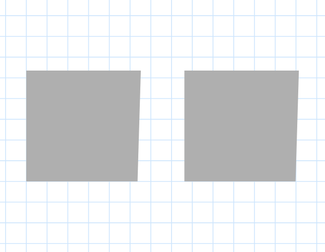

is there a way to create a rectangle box that is 55.2 mm at the heel then tapers in to about 53.5 at the end other that doing it with stepped boxes?
Something like this?
Here are my steps:
  1. Made two squares; one with the smaller dimension for the width and one with the larger dimension for the width
  2. Sent the larger dimension square to the back
  3. Set both ar the same X, Y location
  4. Edited the larger square’s lower right corner to move it to the same place as the topmost square
  5. Made both squares the same depth
  6. Combined both squares
The square on the left is not combined so you can see the two squares. The object on the right is the combined object; a trapezoid.
