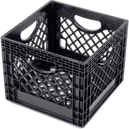

For storage small parts i like to use a Dairy Milk Crate, 13"L X 13"W X 11"H for $5.00

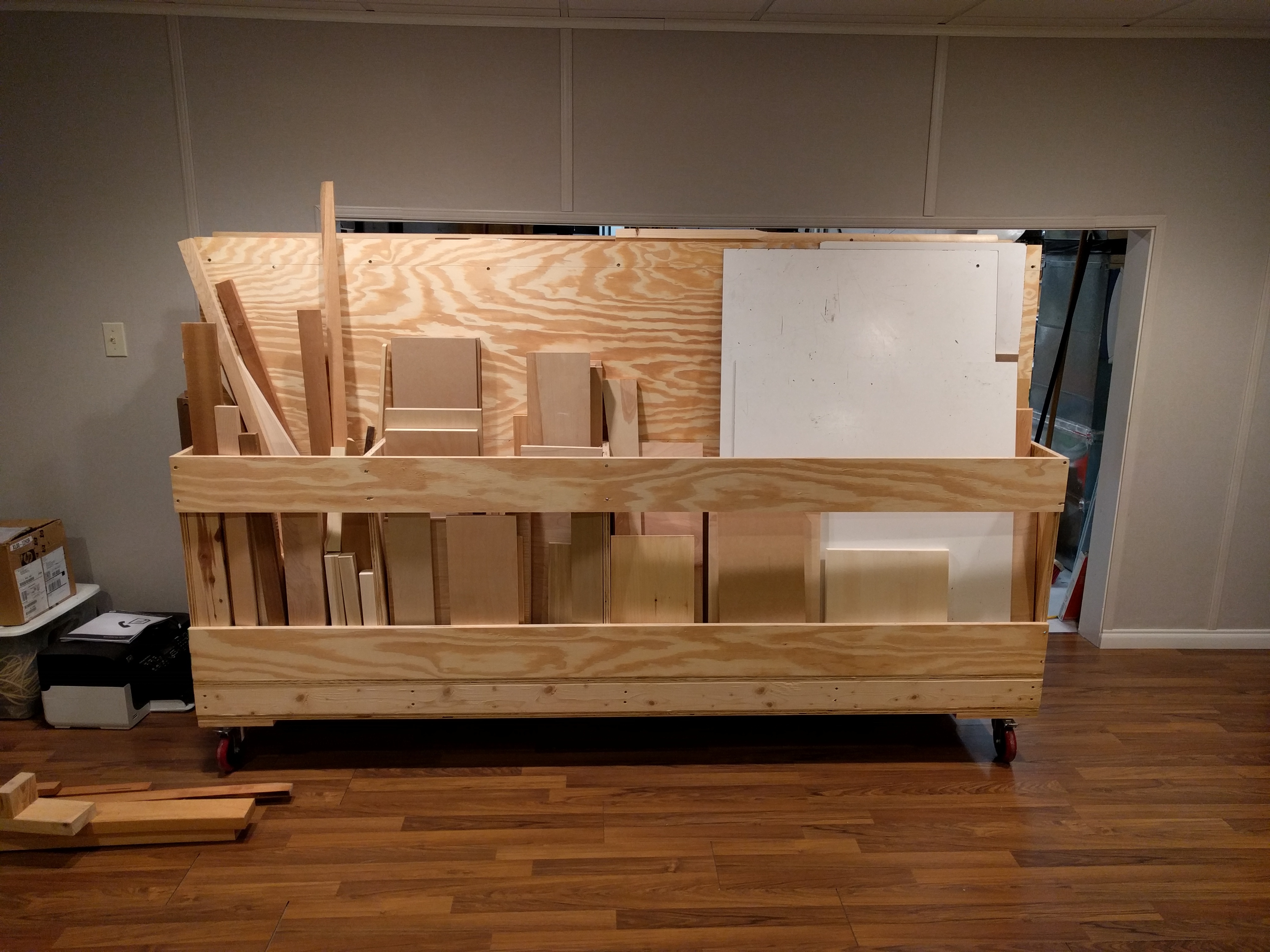

I’ve slowly become a wood collector.
Here is mine. Looks to be mostly the same design.
If you built it again would you change anything?
Here are pictures of my rack. The largest bin on the front side is slightly over 48" wide so I could store half sheets in there. The biggest advice I’d give is to use large wheels so it’ll be easier to roll when fully loaded. I used 5" wheels and they work, but I’d probably go bigger if doing it again. The interior shelves are a tradeoff between what’s the widest piece that’ll fit in there vs how disorganized and wedged in there pieces get. Boards will most likely get slid in there on end, not flat, so I’d make sure at least one shelf could handle slightly more than 12" wide boards - maybe make the space for the bottom shelf higher than the rest and it’s OK to have one smaller one at the top.
The other thing to know is that you will end up putting too many sheets of plywood on the open side and they will have just enough bend in them that it’ll be easy for them to start falling off. I’ve been tempted to put some kind of strap attached to the top with a weight on it that hangs down over the plywood to help hold it in place.

That design makes me a bit nervous, especially if it would be on casters because it is all joints with screws into the end grain of 2x4’s and no triangular reinforcement. If that was freestanding and not against a wall you might be able to push on it and have it fold up.
I’m talking about the one B.F. posted and looking close I don’t see anything but butt joints. Also, unlike house framing it doesn’t have any sheeting on the ends. So if it’s got a full load of wood and you’re pushing it around it looks to me like you’re stressing all those butt joints loose.
I’m a programmer, I was looking at the specs, not the implementation :smiley:
That’s a little better, but also notice the built version doesn’t have casters and is against the wall. Since there is no sheeting on the ends I still wouldn’t want to stress those butt joints with screws into 2x4 end grain.

I like it too, it just has to be built with something better than butt joints or you’ll probably have the opportunity to build it again. At least use dado joints like Phil noticed in the implementation, not the plan above it.
