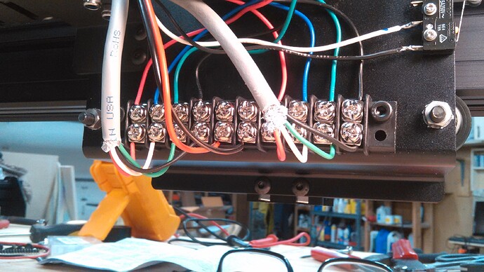

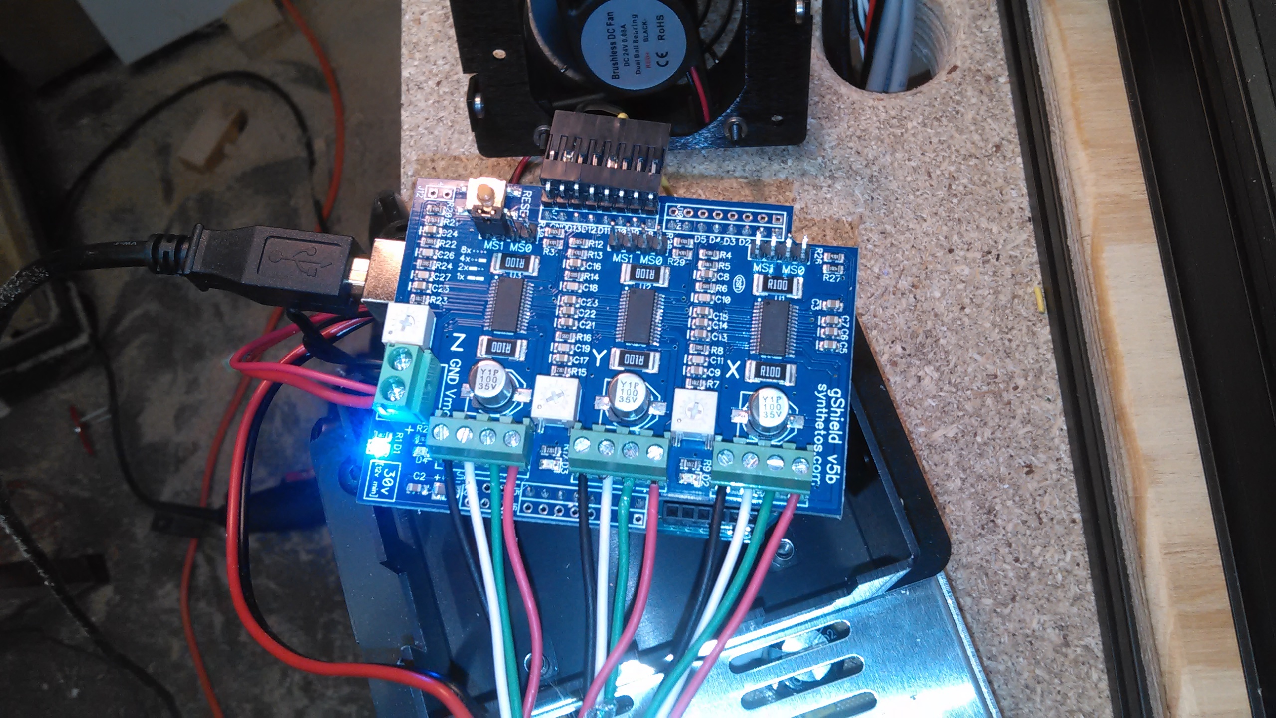

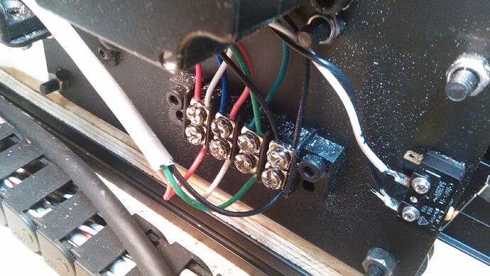

I still haven’t been able to figure out this issue. Can anyone take a look at my wiring pics and see anything unusual? I have been reading in a couple other threads about shielding issues causing stepper motor issues. Did I strip off too much shielding on some of these? If so, where might a person find more wire of this type to purchase?
I removed the control boards from the box, tried many different pot. settings without any difference.

Unless you changed the stepper wiring on purpose, I believe it should look like this.
Also, if you have the NEMA 23 stepper motors sold by Inventables, try setting your pots in this position to start your testing.
With the USB cable plugged in to power the electronics and the 24 volt power supply turned on you should have the blue and three green LEDs lit.
