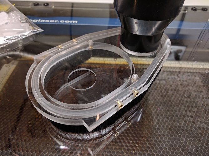

A couple weeks later, oh look, a box in the mail! The boot came in its component parts, with the threaded inserts already installed, and it took me perhaps ten minutes to get it all assembled, about three minutes of which was taken up finding my allen keys to install the magnet-holding slides. The slides are not shown in these two pictures, I added them right after I took these. The only problem I ran into during assembly was that the magnet-holding pockets in one of the slides were not deep enough to actually hold the magnet in place. I resolved that by just removing one of the (identical) magnetic slides from my existing one, and moving it over.
Before I popped it on the router, using the exact same brackets as my first version, I weighed the two of them. The original version weighs 6.4ozs according to my postal scale, the new one 5.3, for a savings of 1.1ozs, or fully 18% of the V1’s weight.
The most obvious feature of the new one, aside from the weight-reducing, tapered design is the cutout for the router. By cutting through the thick portion of the shoe and adding a thin shield at the bottom, they have created a version that addresses my only real problem with the V1 variant: How much depth capability it took off of the router. With this version, the collet can touch the workpiece before the router body touches anything on the shoe, giving that entire range of motion back.
