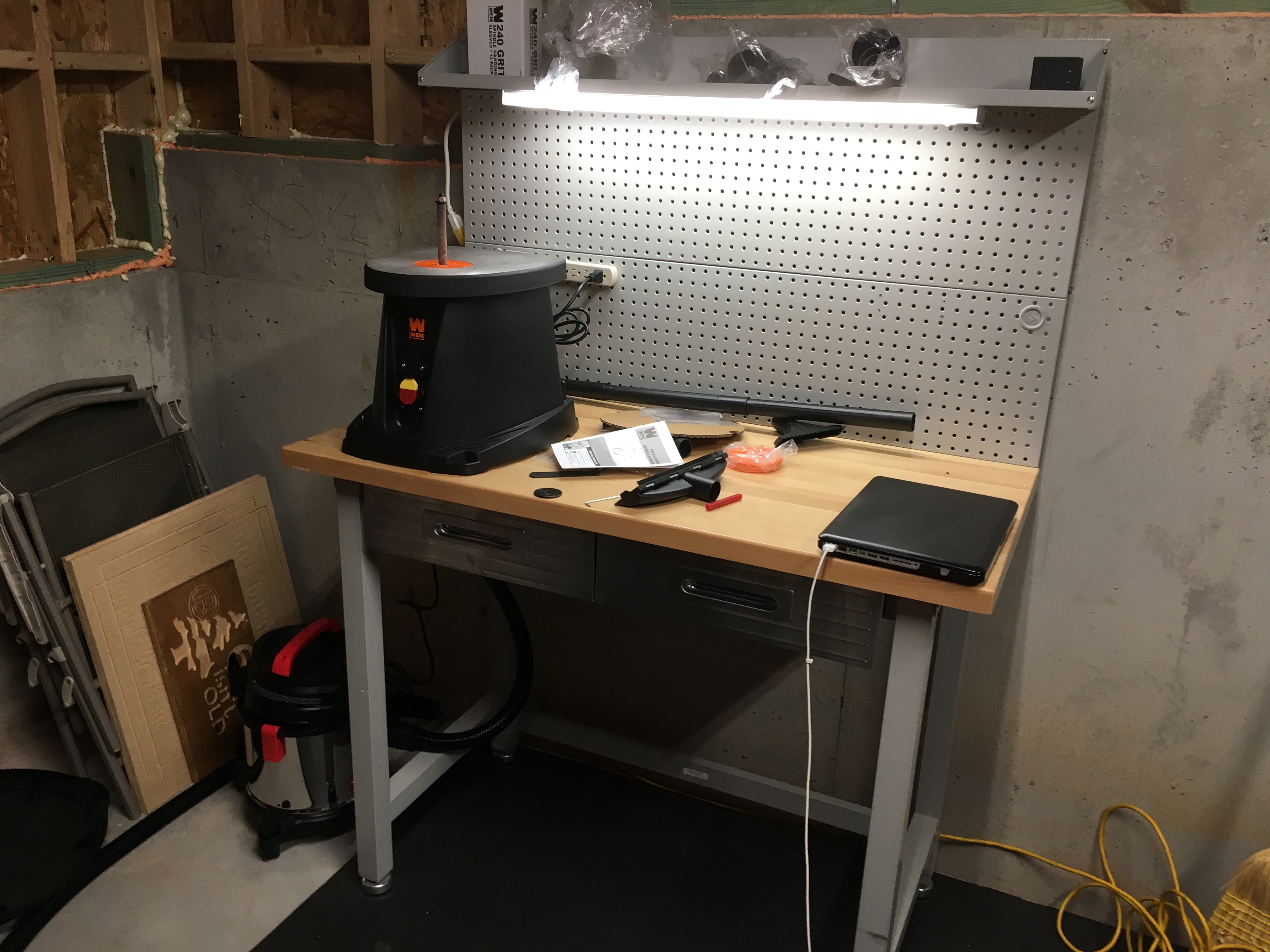

And of course a new toy and workbench:

I just bought that same spindle sander a couple months ago - great value right? Here is a tip - you can compress a buffing wheel between two washers and mount it to the top of your sander! Now it is a sander PLUS a buffer.
P.S. Mine is no longer shiny and new.
Good to know. I’ve got a buffing wheel that may work.
