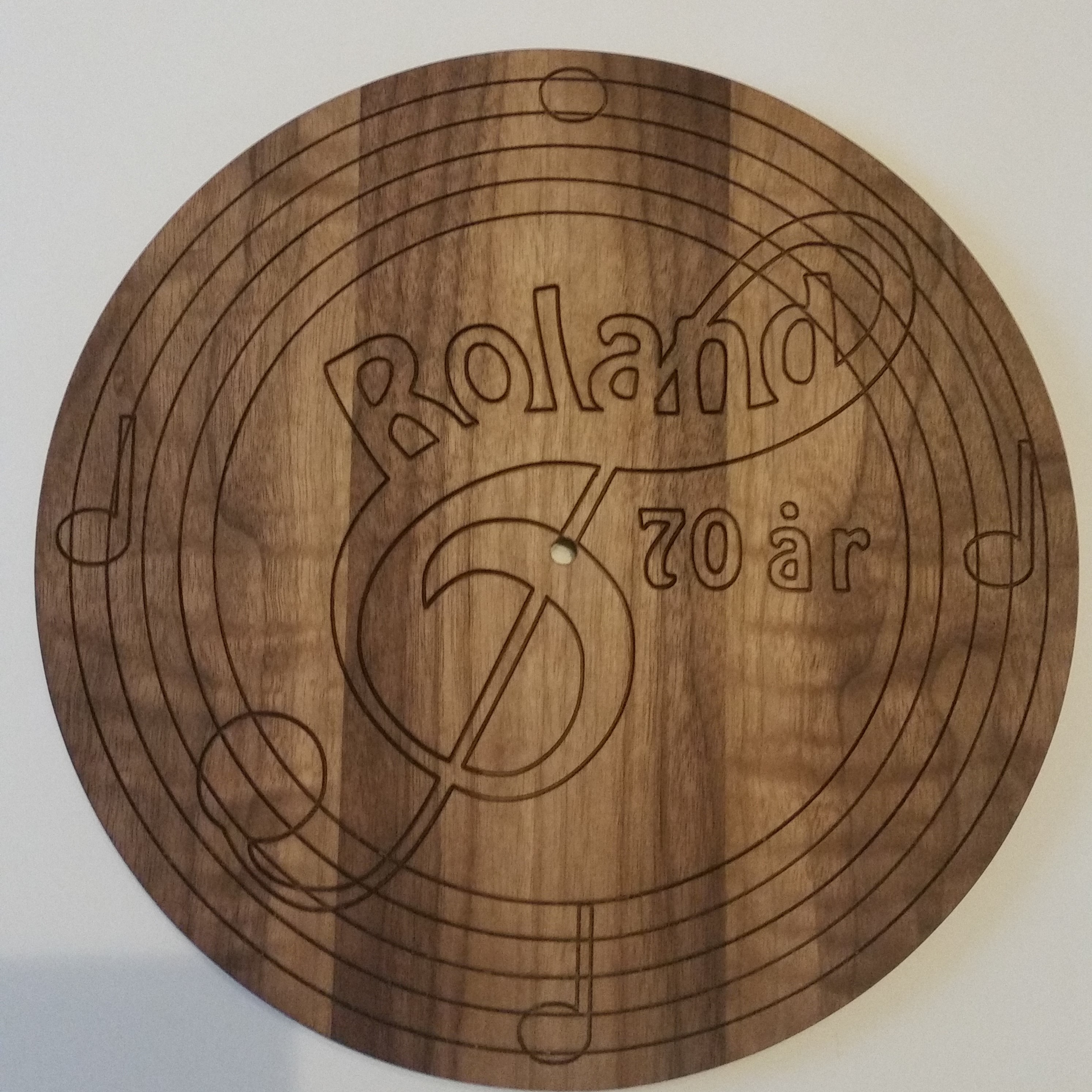

Hi TheWhittler Sir
I try to uplode a picture of my project
Please take a look on it and give me hints
If I should pocket cut the notes or not.
or other hints
Roland 1.crv3d (4.7 MB)Roland 1.dxf (195.8 KB)
To be honest it looks ok with everything just vcarved.
With more time you could add more complex design/toolpaths, but if you are just getting started and you are pushed for time its probably best to keep things simple
Absolutely agree. For something simple like that I would not use Coreldraw as it’s just extra time for nothing.
On the nodes front, wow. What’s going on there? I just looked at the toolpath previews so didn’t see them.
I sometimes delete the odd unnecessary node before exporting from coreldraw, but I’ve never seen so many on a simple curve
My background is graphic design and I use Corel Draw all time time. I have Vetric’s Desktop Pro and Aspire (both awesome programs) but from a design standpoint there is no comparison to a stand alone design program like Corel or Adobe.
I reduce nodes with a couple clicks…

This is how it turned out with all the help from you nice people here
on the great forum
Kristian / Sweden
