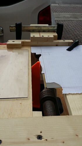

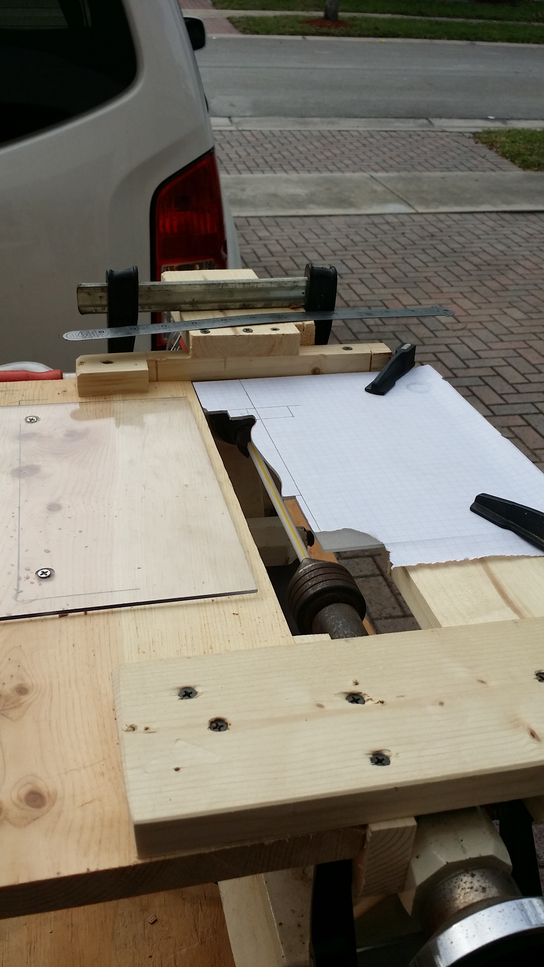

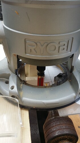

I have “advanced” my production to where, after watching some interesting videos on the interweb, I have attached a Ryobi router with a top bearing bit to run along a Lexan template. I slowly run the router back and forth taking about a .25" of material off the 2" x 6" square, wood stock. I slowly come up on the template to finalize the shape.
The router bit is a .5" top bearing, straight cut bit.
The wooden jg sits on the router and is lined up with witness block and secured in place with clamps.
I put a drinking straw in the lathe on the centers and use a right angle square to line up the template.
I use a second set of clamps to hold the Lexan template in place.
The router bit runs on the downstroke/side of the workpiece, while the lathe spins @ 800RPMs.

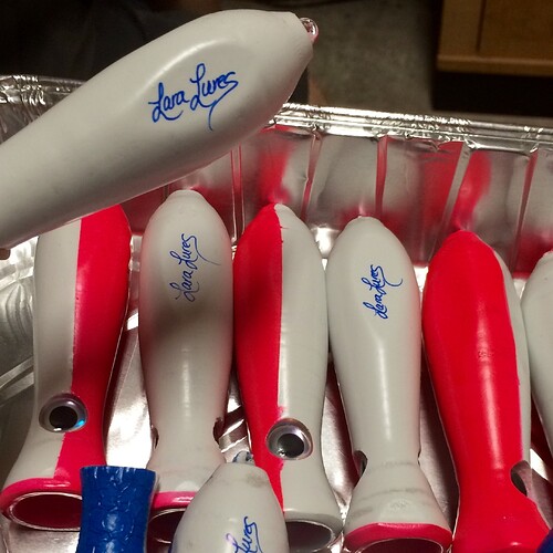

Some additional info…
I now use a parting tool to cleanly cut off the waste block at the bottom.
The waste comes from the safety space to prevent to bit from hitting the live center on the lathe.
I have issues cleaning off the top/face of lure and addtionally creating the cupped face to create the splash.
I cut the top off these, bored a .5" x .25" hole with a Forsner bit and then rounded it with a .75" ball burr, all done on a Jet Drill press. Very Not pretty, nor repeatable or precise.
Some other parts of the process that are a challenge are the drilling of the .05" hole thru the center of the lure

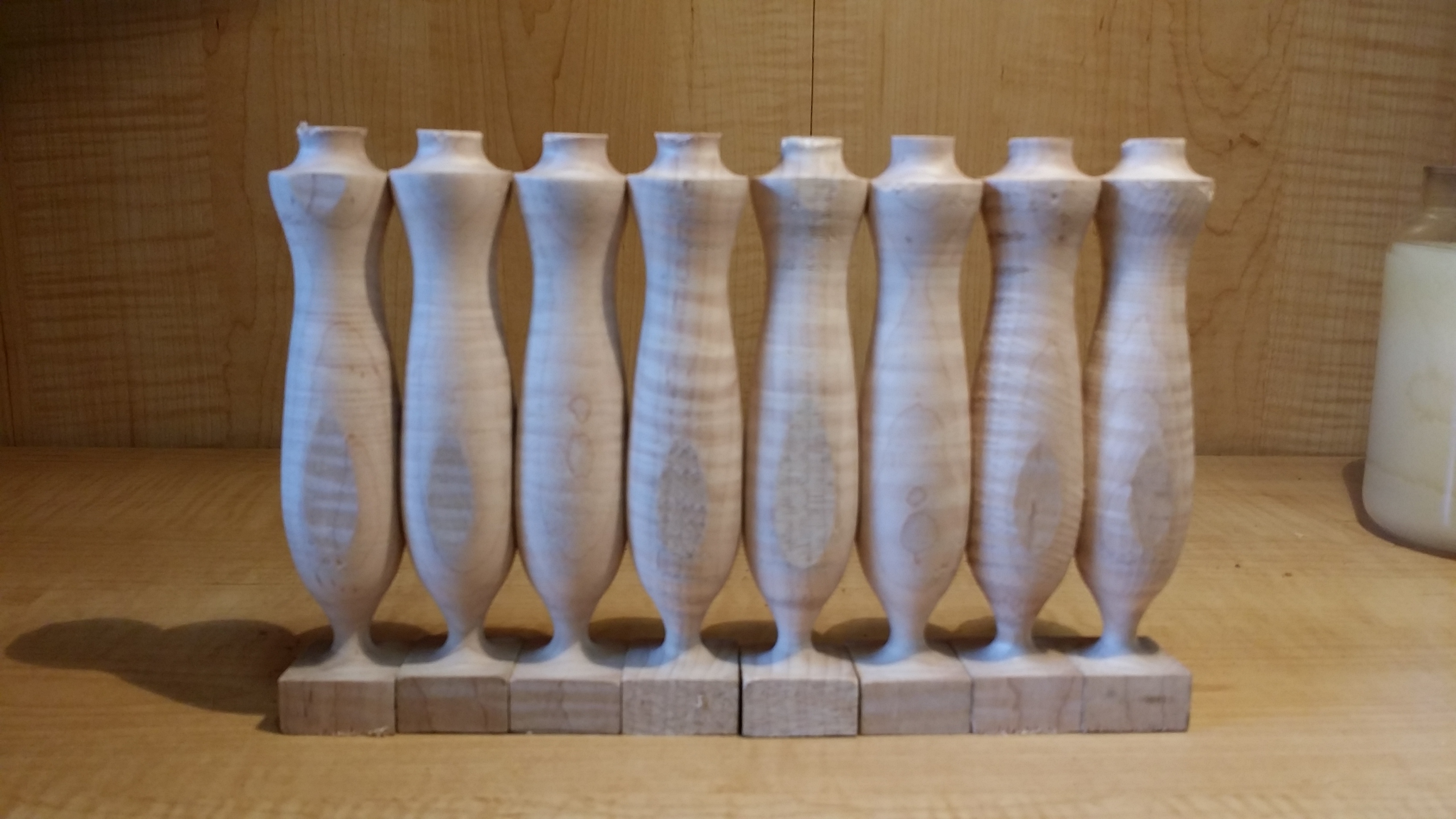

Here’s the results
